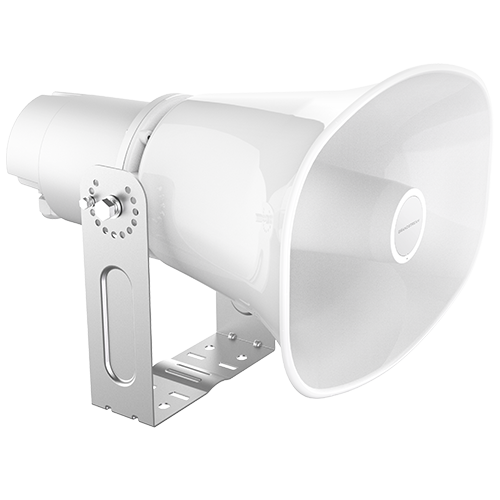

At its core, the GSC3518HS is a network-connected horn speaker that speaks SIP. It registers to any standards-based SIP platform — Grandstream’s UCM series and Wave UC platform included, but also third-party IP PBXs — and can receive pages, multicast announcements, and streamed audio, then answer back. Because it has three built-in microphones with an eight-meter (26-foot) pickup range, two-way talk-back works at distance, which is what makes it an intercom as much as a speaker. Someone can shout a question at the horn from across a yard and the person at the front desk actually hears them.
Add intelligent text-to-speech (type an announcement, have the horn read it), AI-based background noise reduction on the mic inputs, and full-band and wide-band codec support including Opus and G.722, and you have a paging endpoint that keeps announcements intelligible even when it is sitting next to running machinery.

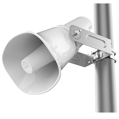

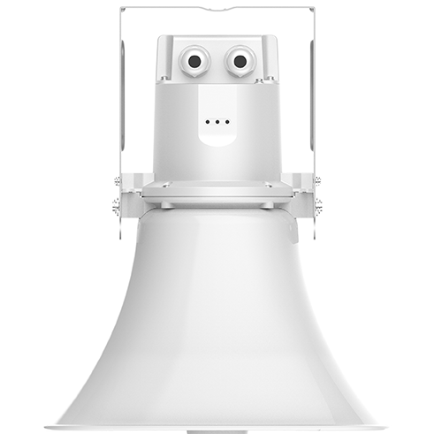

- IP66 weatherproofing — waterproof cable glands, PC + ABS housing with an aluminum back cover and stainless-steel mounting bracket, rated from -30°C to +60°C. This thing is built to live on the side of a building through a decade of weather

3. Outdoor campuses, office parks, and mixed indoor/outdoor sites. Multi-floor, multi-zone paging with cascaded playback gives corporate announcements real reach. The PoE++ pass-through is the infrastructure win here — if your network drops to one outdoor pole anyway, feeding the horn and daisy-chaining the camera or AP downstream saves a second cable run, and PoE runs are dramatically cheaper than individual power drops plus the licensed electrician hours that come with them.
