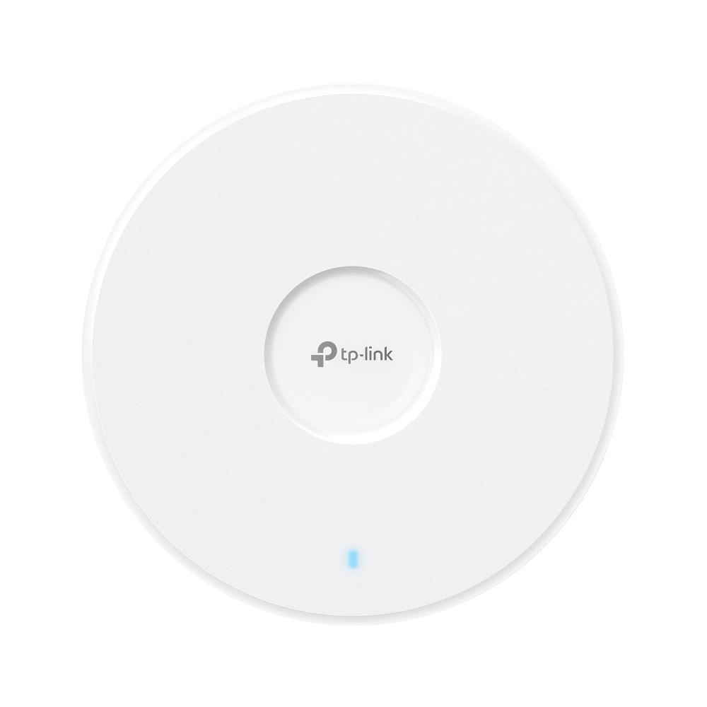

The EAP773 is TP-Link’s ceiling-mount flagship of its Omada Wi-Fi 7 line for SMB: a BE9300-class tri-band AP (6 GHz + 5 GHz + 2.4 GHz), a single 10G Ethernet uplink, PoE powered, and fully managed by the Omada SDN controller like every other EAP in the family. It is the AP you put in when the customer wants Wi-Fi 7 on the invoice and you want a switch port that will never be the bottleneck.

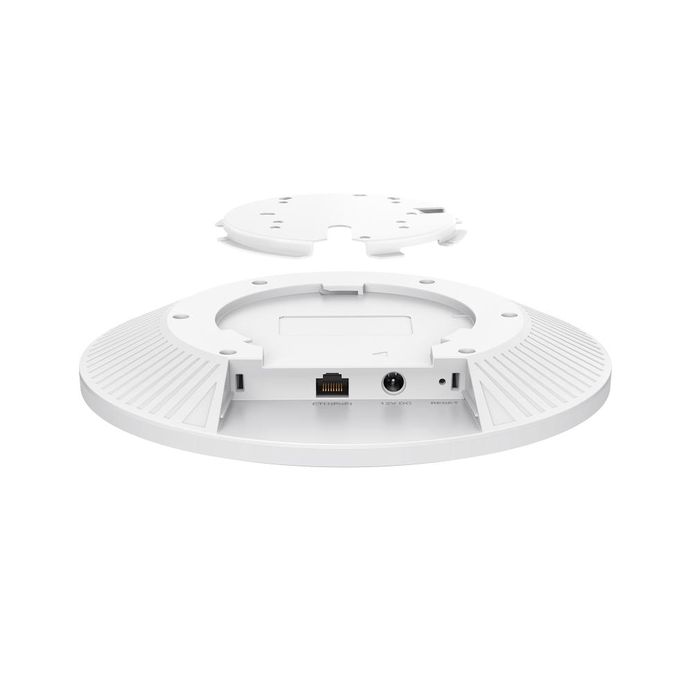

Read the power line twice. TP-Link’s marketing calls the port “10G PoE+” while the official spec table says 802.3bt. The honest install read: plan a budget of roughly 26 W per AP on your switch and use 802.3bt ports where you can. If you park them on 802.3at ports the AP degrades gracefully (it throttles 6 GHz transmit power to stay under 25 W) — it works, but you paid for a 6 GHz radio, so feed it properly.
The single 10G port is the star feature and also the gotcha. On a 9214 Mbps aggregate PHY the uplink will always be the bottleneck, but a clean 10G pipe means five or six Wi-Fi 7 laptops pulling real multi-gig throughput through one AP on a controller-managed VLAN is a normal Tuesday. What you cannot do is daisy-chain — one port, one run back to the switch. Budget the switch ports accordingly: an eight-port multi-gig or a 10G SFP+ edge on your Omada switch is what makes this AP sing.
Bluetooth 5.2 is on board (with a firmware caveat flagged right in the datasheet), which future-proofs it for asset-tag and BLE-assisted provisioning features as the Omada controller matures them. Bring firmware current at handover — it also unlocks the auto channel and power optimization features when the AP joins an Omada controller.
Mounting is the easy part: the disc is 32.5 mm thin with a groove around the top cover so it sits flush on tight ceiling tiles, and both ceiling and wall kits ship in the box. On a drop-ceiling grid I still use T-rails and j-hooks for the patch run — a 10G patch lead dangling off a grid tee is how link flaps get born.
