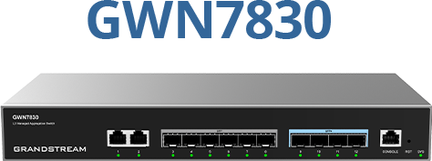

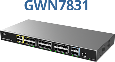

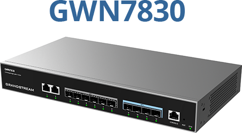

The GWN7830 series is three switches built on one firmware family. Every model runs full Layer 3 — dynamic routing, not the “L3 lite” static-pretending stuff you see on cheaper aggregation boxes. Where they differ is port density, throughput, and power redundancy:
| Spec | GWN7830 | GWN7831 | GWN7832 |
| Gigabit Ethernet ports | 2 | 4x combo | — |
| 1G SFP ports | 6 | 24 | — |
| 10G SFP+ ports | 4 | 4 | 12 |
| Total non-blocking throughput | 48Gbps | 64Gbps | 120Gbps |
| Switching capability | 96Gbps | 128Gbps | 240Gbps |
| Forwarding rate | 71.424Mpps | 95.232Mpps | 178.56Mpps |
| Packet buffer | 12Mb | 12Mb | 16Mb |
| Network latency | <4µs | <4µs | <2µs |
| MAC table | 16K | 16K | 32K |
| Integrated power supply | 30W | 60W | 60W |
| External redundant power (RPS) | Not supported | 12V/60W (RPS-60W-B) | 12V/60W (RPS-60W-B) |
| Standalone routing table | 512 IPv4 / 128 IPv6 routes | 12K IPv4 / 4K IPv6 routes (top-spec column) | |
Installer note on the table: Grandstream’s datasheet prints the L3/L2 feature set across the series — the 32K MAC table, 64 spanning-tree instances, and the big route table land in the top-spec column, so if you need the full table on a single switch, that’s the GWN7832. All models do support dynamic routing including RIP, RIPng, OSPF, OSPFv3, and BGP.

Multi-tenant MDU or commercial building. GWN7831 in the basement: 24 GbE SFP ports feed fiber drops to each suite riser, DAI plus port security keeps one tenant’s misbehaving gear from poisoning DHCP for everyone, and 802.1X/RADIUS ties into your existing auth if you run it.

Budget-friendly core upgrade. The GWN7830 as the entry point: small office, four SFP+ uplinks, a couple of copper ports for the firewall and management, OSPF if the upstream wants it. No redundant power, so put it on a clean UPS like everything else in the rack.
