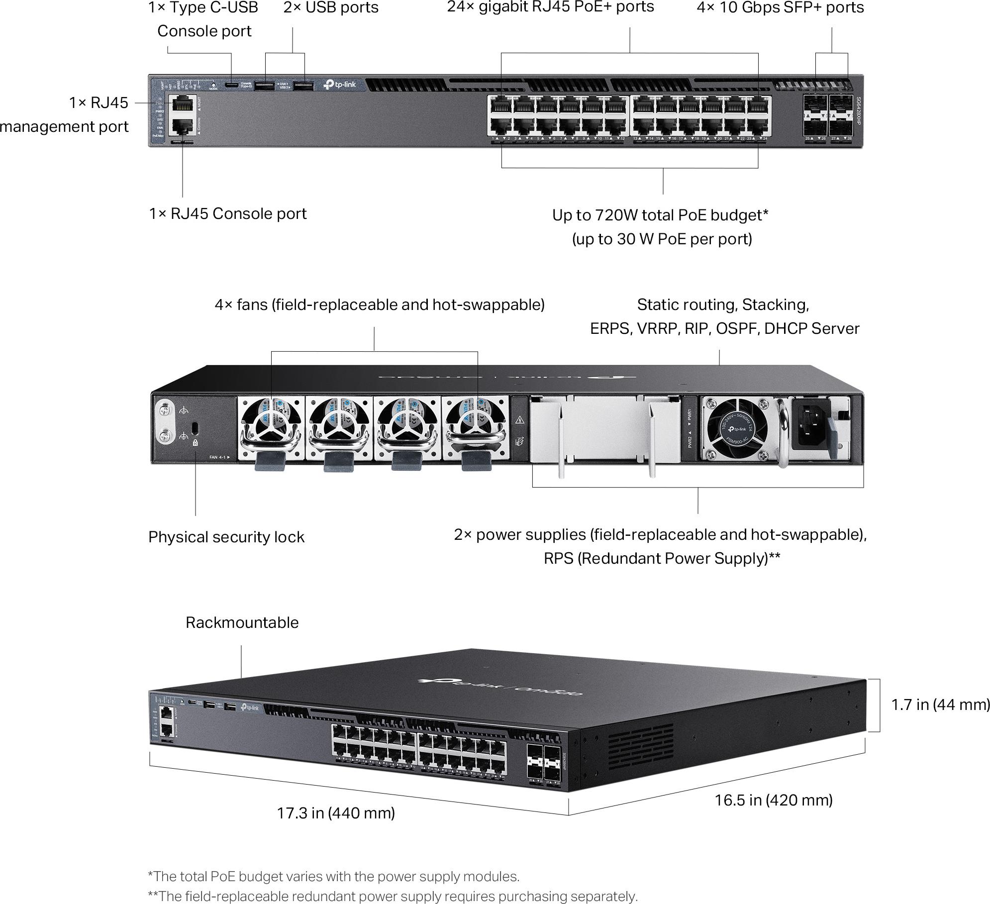

| Ports | 24x 10/100/1000 Mbps PoE+ RJ45 + 4x 10G SFP+ slots |
| PoE standard | IEEE 802.3af/at, up to 30 W per port, Perpetual PoE and Fast PoE |
| PoE budget | 402 W with one PSM500-AC (shipped); up to 720 W with PSM900-AC or dual PSM500-AC |
| Switching capacity | 128 Gbps; 64 Gbps forwarding bandwidth; 95.2 Mpps |
| MAC table / routes | 32K MAC addresses; 10,240 hardware route entries |
| CPU / memory | Dual-core ARM @ 1.5 GHz, 4 GB DDR4 DRAM |
| Layer 3 | Static routing, RIP, OSPF, ECMP, VRRP, PIM-DM/PIM-SM, DHCP server/relay |
| Stacking | Up to 8 units standalone / 4 via controller; up to 80 Gbps stacking bandwidth (4 stacking ports); MAD detection, virtual MAC |
| Power | Two slots, hot-swappable N+1 redundant (one PSM500-AC ships in the box) |
| Reliability | ERPS ring protection, VRRP, 4 hot-swap fans (N+1), front-to-back airflow, MTBF ~753,531 h @ 25°C |
| Management | Omada SDN (cloud/controller + ZTP), standalone web GUI, CLI, SNMP v1/v2c/v3, RMON |
| Security | ACL (IPv4/IPv6), 802.1X, MAB, Dynamic ARP Inspection, port security, DoS defend, SSH |
| Physical | Rackmount, 440 x 420 x 44 mm, 7.64 kg; console RJ45 + USB-C; 2x USB 2.0 ports |

The power budget is the headline. Four hundred and two watts on the shipped supply is already more than most 24-port switches in this price class. Add the second slot — a PSM900-AC or a second PSM500 — and you are at 720 watts, which is enough to run a full bank of 30-watt PTZ cameras or Wi-Fi 6/7 APs without playing roulette. Perpetual PoE is the feature I care about most here: the ports keep power to your devices while the switch itself reboots for a firmware update. Anybody who has had to walk a ladder to reboot a camera that dropped during a switch reload knows what that is worth in truck-rolls.
Real L3, not marketing L3. OSPF, ECMP, VRRP, PIM multicast, and a built-in DHCP server/relay with over 10,000 hardware route entries. On multi-VLAN commercial sites this means you can terminate routing at the distribution layer instead of hairpinning everything through the firewall. If you are still routing inter-VLAN traffic on an ER605 for a 60-VLAN site, this is the class of box you move that job to.
Stacking with actual redundancy. Eight units in standalone mode, four under controller management, stacking across SFP+ slots at up to 80 Gbps, with multi-active detection. For a two-closet warehouse or a two-building campus, a stacked pair gives you one management brain and surviving ring/crown topology — features that were enterprise-brand-only money five years ago.

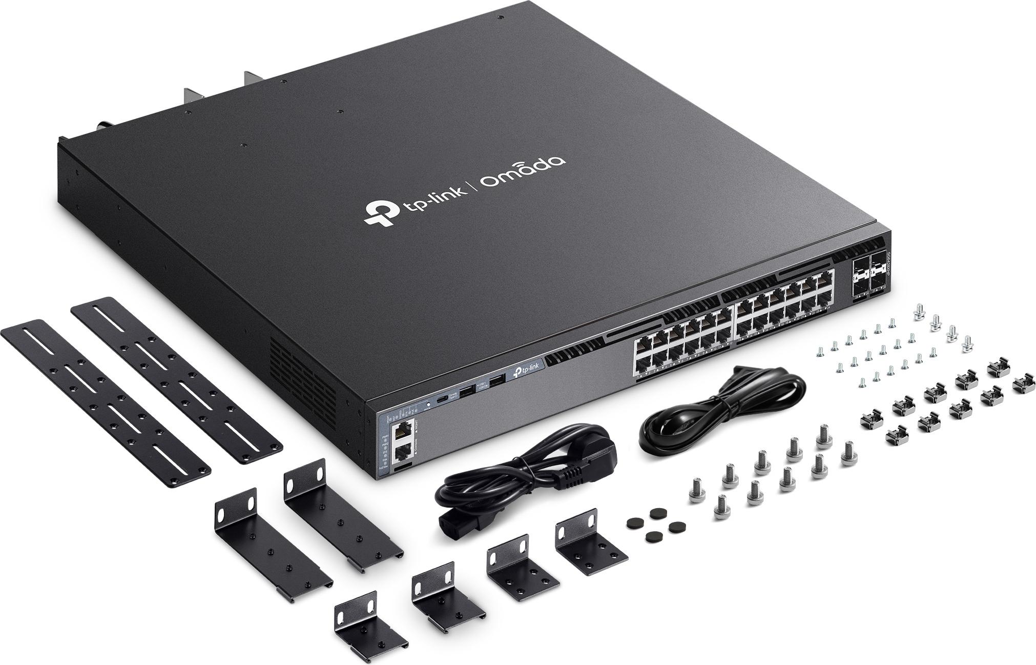

A few things I would flag before you rack one. First, order the second power supply with the switch, not after the first outage window — the box ships with a single PSM500-AC, and the full 720-watt budget only exists on paper until that second module is clicked in. Second, mind the fine print on the SFP+ slots: only two of the four accept 10G RJ45 modules (slots 49 and 53), so plan your fiber versus copper uplinks before the truck loads. Third, the fan noise is honest rack-room noise — up to about 57 dBA at full tilt — so this does not belong in a closet above someone’s office. Fourth, if you stack through the Omada controller, your stack ceiling drops from eight units to four; standalone stacking keeps the full eight. None of these are dealbreakers, they are just the asterisks that separate a clean install from a callback. One last practical note: the console is RJ45 plus USB-C. The USB-C console is the one, and having the serial console on USB-C means one fewer dongle in the bag on a laptop-era service call — a small thing that you appreciate at seven in the morning on a ladder.
