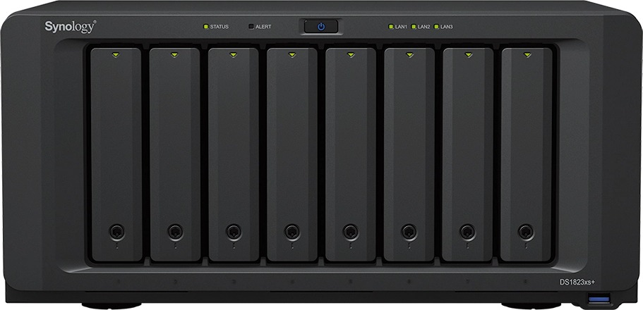

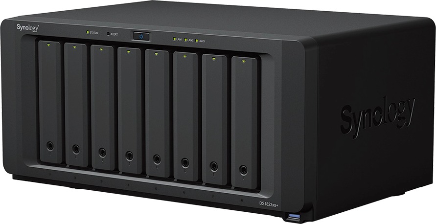

The DS1823xs+ is the oddball in Synology’s lineup: an eight-bay tower instead of a rackmount, but with xs-series hardware underneath — ECC memory, a built-in 10GbE port, an out-of-band management port, and a real PCIe slot. Synology pitches it as storage for businesses without a dedicated server rack, and that framing is exactly right. If you have a closet shelf but not a rack, this is the box.

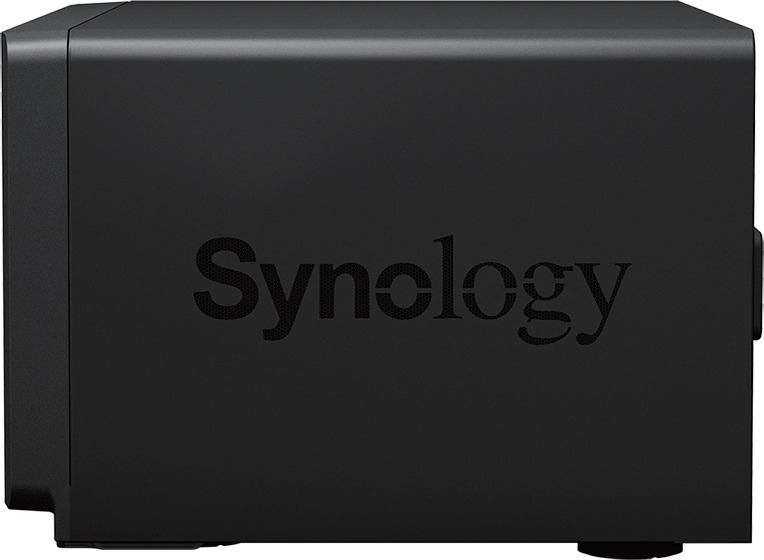

| Size / weight | 166 × 343 × 243 mm, 6.2 kg; two 120 mm fans, easy-replacement; 23.6 dB(A) idle |

- Offices without a rack. The tower form factor is the whole point. At 23.6 dB(A) idle you can keep it on a shelf in a back office instead of buying a rack and a shelf just to house a NAS. Keep it off the floor — cable management loops ten inches high will vacuum its intake airflow.

- VM and virtualization storage. ECC onboard, NVMe cache, 10GbE standard, DX517 expansion for a second tier. Treat the M.2 slots as the cache pair (they are not hot-swappable — plan the thermal pads), and keep the datastore volume on the front bays so drive swaps never touch the cache.
