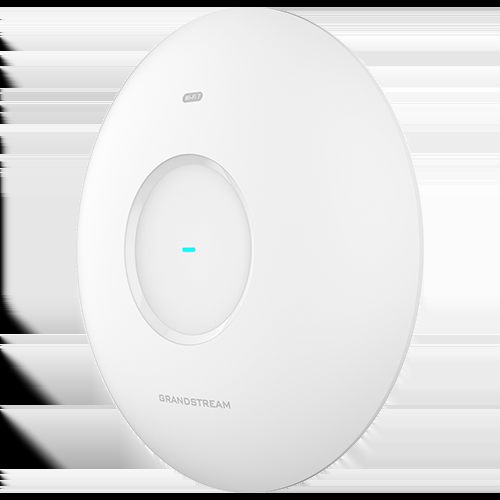

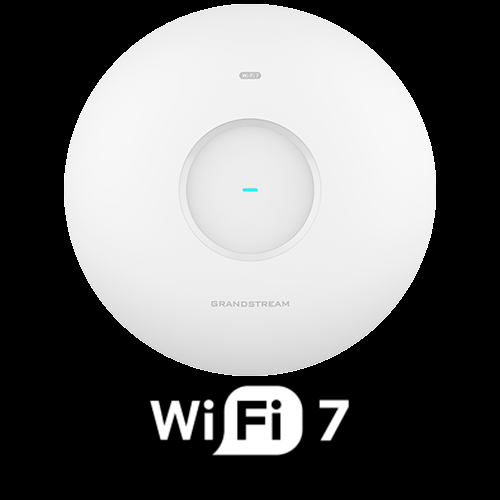

The Grandstream GWN7674 is the flagship of the GWN Wi-Fi 7 line: tri-band BE21000 with 21Gbps aggregate wireless throughput, a 10G Ethernet uplink, PoE++ budget of 36W, and support for up to 768 concurrent clients. It is the only AP in Grandstream’s indoor lineup where the wired side actually matches the radios, and it is managed for free — embedded controller, GWN Manager, or GDMS cloud. For a medium-to-large site with real client density, it earns its spot at the top of the bill of materials.
What the GWN7674 actually is
Grandstream has been quietly building out a full Wi-Fi 7 (802.11be) family, and the GWN7674 sits at the top of the indoor range. Where the rest of the family makes compromises — 2×2:2 radios, 2.5G uplinks, sub-5Gbps aggregate throughput — the 7674 goes all in: 4×4:4 MU-MIMO on both 5GHz and 6GHz, 2×2:2 on 2.4GHz, 12 built-in antennas, and a real 10G Ethernet port so the wired side stops being the bottleneck. Grandstream rates the aggregate wireless throughput at 21Gbps (BE21000) against 12.5Gbps aggregate wired across its 10G and 2.5G ports.
The radios support the full Wi-Fi 7 toolkit Grandstream advertises across the line: MLO (multi-link operation), 4K QAM, MRU (multi-RU allocation), and preamble puncturing. Coverage is rated up to 175 meters, and the AP handles up to 768 concurrent clients with 48 SSIDs total — 16 per radio across all three bands.
Verified specifications (Grandstream product page)
| Standard | IEEE 802.11 a/b/g/n/ac/ax/be (Wi-Fi CERTIFIED 7), MLO, 4K QAM, MRU, preamble puncturing |
| Radios | Tri-band: 2.4GHz 2×2:2 (688Mbps), 5GHz 4×4:4 (8647Mbps), 6GHz 4×4:4 (11529Mbps) — 21Gbps aggregate |
| Wired | 1x 10G Ethernet WAN/LAN, 1x 2.5G Ethernet WAN/LAN (12.5Gbps aggregate wired) |
| Client capacity | Up to 768 concurrent clients; 48 SSIDs (16 per radio) |
| Coverage | Up to 175 meters (vendor rating) |
| Power | 802.3bt PoE++ with auto-detection and self-power adaptation; max 36W |
| Security | WPA3-SAE and WPA3-802.1x (plus WPA2 flavors), anti-hacking secure boot, per-device digital signatures, unique security certificate and random default password per device, MAC filtering, client isolation, OS filtering, inbound/outbound traffic rules, rogue AP detection and containment, ARP/ND attack defense |
| Management | Free: embedded controller (up to 50 local APs), GWN Manager on-prem software (unlimited), GDMS Networking cloud (unlimited), GDMS mobile app |

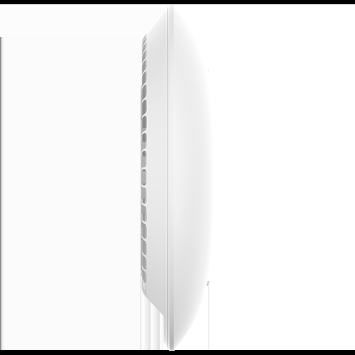

| Physical | 250 x 250 x 54.5mm; indoor wall or ceiling mount, kits included |
